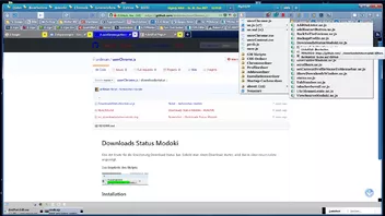

moin
es geht um
siehe ewtl. Bild
Alles anzeigen// ==UserScript== // @name ucjsDownloadsStatusModoki.uc.js // @namespace http://space.geocities.yahoo.co.jp/gl/alice0775 // @description Downloads Status Modoki // @include main // @compatibility Firefox 26+ // @author Alice0775 // @version 2016/06/10 12:00 modify style independent of font-family // @version 2016/06/10 07:00 modify style of close button, fix typo // @version 2016/06/10 00:00 Workaround Bug 1279329. adjust some padding // @version 2015/05/08 00:00 remove padding due to Bug 1160734 // @version 2014/03/31 00:00 fix for browser.download.manager.showWhenStarting // @version 2013/12/22 13:00 chromehidden // @version 2013/12/19 17:10 rename REMEMBERHISTOTY to DO_NOT_DELETE_HISTORY // @version 2013/12/16 23:28 fixed initialize numDls // @version 2013/12/16 23:24 open only download added // @version 2013/12/16 23:10 open only download started // @version 2013/12/16 21:20 modify css Windows7 Aero // @version 2013/12/16 21:00 modify css // @version 2013/12/16 19:30 add autocheck false // @version 2013/12/16 18:31 fix pref name // @version 2013/12/16 18:30 // @note // ==/UserScript== var ucjsDownloadsStatusModoki = { _summary: null, _list: null, get downloadsStatusModokiBar() { delete downloadsStatusModokiBar; return this.downloadsStatusModokiBar = document.getElementById("downloadsStatusModokiBar"); }, get toggleMenuitem() { delete toggleMenuitem; return this.toggleMenuitem = document.getElementById("toggle_downloadsStatusModokiBar"); }, init: function() { if (document.documentElement.getAttribute("chromehidden") !="" ) return; XPCOMUtils.defineLazyModuleGetter(window, "Downloads", "resource://gre/modules/Downloads.jsm"); var style = ' \ @namespace url(http://www.mozilla.org/keymaster/gatekeeper/there.is.only.xul); \ #ucjsDownloadsStatusModoki { \ width: 100%; \ max-height: 100px; \ height: 35px; \ } \ '.replace(/\s+/g, " "); var sspi = document.createProcessingInstruction( 'xml-stylesheet', 'type="text/css" href="data:text/css,' + encodeURIComponent(style) + '"' ); document.insertBefore(sspi, document.documentElement); sspi.getAttribute = function(name) { return document.documentElement.getAttribute(name); }; var toolbar = document.createElement("vbox"); toolbar.setAttribute("id", "downloadsStatusModokiBar"); toolbar.setAttribute("collapsed", true); var bottombox = document.getElementById("browser-bottombox"); bottombox.appendChild(toolbar); var browser = toolbar.appendChild(document.createElement("browser")); browser.setAttribute("disablehistory", true); browser.setAttribute("remote", false); browser.setAttribute("id", "ucjsDownloadsStatusModoki"); browser.addEventListener("load", function(event){ucjsDownloadsStatusModoki.onload(event)}, true); browser.setAttribute("src", "chrome://browser/content/downloads/contentAreaDownloadsView.xul"); var menuitem = document.createElement("menuitem"); menuitem.setAttribute("id", "toggle_downloadsStatusModokiBar"); menuitem.setAttribute("type", "checkbox"); menuitem.setAttribute("autocheck", false); menuitem.setAttribute("label", "Downloads Statusbar"); menuitem.setAttribute("checked", false); menuitem.setAttribute("accesskey", "D"); menuitem.setAttribute("oncommand", "ucjsDownloadsStatusModoki.toggleDownloadsStatusModokiBar()"); var ref = document.getElementById("menu_customizeToolbars"); ref.parentNode.insertBefore(menuitem, ref.previousSibling); // Ensure that the DownloadSummary object will be created asynchronously. if (!this._summary) { Downloads.getSummary(Downloads.ALL).then(summary => { this._summary = summary; return this._summary.addView(this); }).then(null, Cu.reportError); } if (!this._list) { Downloads.getList(Downloads.ALL).then(list => { this._list = list; return this._list.addView(this); }).then(null, Cu.reportError); } window.addEventListener("unload", this, false); }, uninit: function() { window.removeEventListener("unload", this, false); if (this._summary) { this._summary.removeView(this); } if (this._list) { this._list.removeView(this); } }, handleEvent: function(event) { switch (event.type) { case "unload": this.uninit(); break; } }, toggleDownloadsStatusModokiBar: function() { var collapsed = this.downloadsStatusModokiBar.collapsed; this.downloadsStatusModokiBar.collapsed = !collapsed; this.toggleMenuitem.setAttribute("checked", collapsed); }, openDownloadsStatusModoki: function() { this.downloadsStatusModokiBar.collapsed = false; this.toggleMenuitem.setAttribute("checked", true); }, hideDownloadsStatusModoki: function() { this.downloadsStatusModokiBar.collapsed = true; this.toggleMenuitem.setAttribute("checked", false); }, onDownloadAdded: function (aDownload) { Cu.import("resource://gre/modules/Services.jsm"); var showWhenStarting = true; try { showWhenStarting = Services.prefs.getBoolPref("userChrome.downloadsStatusModoki.showWhenStarting"); } catch(e) {} this.numDls = 0; if (showWhenStarting) { if (this._list) { this._list.getAll().then(downloads => { for (let download of downloads) { if (!download.stopped) this.numDls++; } if (this.numDls > 0) this.openDownloadsStatusModoki(false); }).then(null, Cu.reportError); } } }, onSummaryChanged: function () { Cu.import("resource://gre/modules/Services.jsm"); if (!this._summary) return; if (this._summary.allHaveStopped || this._summary.progressTotalBytes == 0) { var closeWhenDone = false; try { closeWhenDone = Services.prefs.getBoolPref("userChrome.downloadsStatusModoki.closeWhenDone"); } catch(e) {} if (closeWhenDone) { this.hideDownloadsStatusModoki(); } } }, // chrome://browser/content/downloads/contentAreaDownloadsView.xul onload: function(event) { var doc = event.originalTarget; var win = doc.defaultView; var style = ' \ @namespace url(http://www.mozilla.org/keymaster/gatekeeper/there.is.only.xul); \ #contentAreaDownloadsView { \ -moz-box-orient: horizontal; \ padding: 0; \ } \ \ #downloadsRichListBox { \ max-height:35px; \ background-color: -moz-dialog; \ } \ \ #downloadsRichListBox .scrollbox-innerbox { \ display:inline !important; \ } \ \ richlistitem { \ min-width:200px; \ max-width:200px; \ max-height:33px; \ font-size: 13px; \ padding-right: 1px; \ } \ \ richlistitem vbox { \ } \ \ .downloadTypeIcon { \ height:16px; \ width: 24px; \ -moz-margin-end: 0px; \ -moz-margin-start: 1px; \ padding-right: 0; \ padding-left: 1px; \ } \ \ .downloadTarget { \ margin-top:2px; \ padding-bottom:16px; \ max-width: calc(100% - 50px) !important; \ min-width: calc(100% - 50px) !important; \ } \ \ .downloadTarget:-moz-system-metric(windows-default-theme) { \ margin-top:2px; \ padding-bottom:10px; \ } \ \ .downloadProgress { \ margin-top:-16px; \ margin-bottom: -1px; \ } \ \ .progress-bar { \ -moz-appearance:none !important; \ background-color: lime !important; \ } \ \ .progress-remainder { \ } \ \ .downloadDetails { \ margin-top:-17px; \ } \ \ richlistitem[selected] .downloadDetails { \ opacity: 1; \ } \ \ .downloadButton { \ padding: 0; \ margin: 0; \ } \ \ .button-box { \ -moz-padding-start: 0px; \ -moz-padding-end: 1px; \ padding-right: 0 !important; \ padding-left: 0 !important; \ } \ \ #downloadFilter { \ width: 150px; \ } \ \ #ucjsDownloadsStatusModoki-closebutton { \ border: none; \ width:20px;\ padding: 0 5px; \ list-style-image: url("chrome://global/skin/icons/close.png"); \ -moz-appearance: none; \ -moz-image-region: rect(0, 20px, 20px, 0); \ } \ \ #ucjsDownloadsStatusModoki-closebutton:hover { \ -moz-image-region: rect(0px, 40px, 20px, 20px); \ } \ \ @media (-moz-windows-classic) { \ #ucjsDownloadsStatusModoki-closebutton { \ border: none; \ padding: 0 5px; \ list-style-image: url("chrome://global/skin/icons/close.png"); \ -moz-appearance: none; \ -moz-image-region: rect(0, 16px, 16px, 0); \ } \ \ #ucjsDownloadsStatusModoki-closebutton:hover { \ -moz-image-region: rect(0px, 32px, 16px, 16px); \ } \ } \ '.replace(/\s+/g, " "); var sspi = doc.createProcessingInstruction( 'xml-stylesheet', 'type="text/css" href="data:text/css,' + encodeURIComponent(style) + '"' ); doc.insertBefore(sspi, doc.documentElement); sspi.getAttribute = function(name) { return doc.documentElement.getAttribute(name); }; var button = doc.createElement("button"); button.setAttribute("label", "Löschen"); button.setAttribute("accesskey", "L"); button.setAttribute("oncommand", "ucjsDownloadsStatusModoki_clearDownloads();"); var ref = doc.getElementById("downloadCommands"); var vbox = doc.createElement("vbox"); var box = vbox.appendChild(doc.createElement("hbox")); box.appendChild(button); box.appendChild(doc.createElement("spacer")).setAttribute("flex", 1); var textbox = doc.createElement("textbox"); textbox.setAttribute("id", "downloadFilter"); textbox.setAttribute("clickSelectsAll", true); textbox.setAttribute("type", "search"); textbox.setAttribute("placeholder", "Suchen..."); textbox.setAttribute("oncommand", "ucjsDownloadsStatusModoki_doSearch(this.value);"); box.appendChild(textbox); var closebtn = doc.createElement("toolbarbutton"); closebtn.setAttribute("id", "ucjsDownloadsStatusModoki-closebutton"); closebtn.setAttribute("tooltiptext", "Download-Leiste schließen"); closebtn.setAttribute("oncommand", "ucjsDownloadsStatusModoki_doClose();"); box.appendChild(closebtn); ref.parentNode.insertBefore(vbox, ref); // xxx Bug 1279329 "Copy Download Link" of context menu in Library is grayed out var listBox = doc.getElementById("downloadsRichListBox"); var placesView = listBox._placesView; if (placesView) { var place = placesView.place; placesView.place= null; placesView.place = place; } win.ucjsDownloadsStatusModoki_clearDownloads = function ucjs_clearDownloads() { var DO_NOT_DELETE_HISTORY = true; /* custmizable true or false */ Cu.import("resource://gre/modules/Services.jsm"); var places = []; function addPlace(aURI, aTitle, aVisitDate) { places.push({ uri: aURI, title: aTitle, visits: [{ visitDate: aVisitDate, transitionType: Ci.nsINavHistoryService.TRANSITION_LINK }] }); } function moveDownloads2History() { var richListBox = doc.getElementById("downloadsRichListBox"); if (DO_NOT_DELETE_HISTORY) { var cont = richListBox._placesView.result.root; cont.containerOpen = true; for (let i = cont.childCount - 1; i > -1; i--) { let node = cont.getChild(i); let aURI = makeURI(node.uri); let aTitle = node.title; let aVisitDate = node.time; addPlace(aURI, aTitle, aVisitDate) } } // Clear List richListBox._placesView.doCommand('downloadsCmd_clearDownloads'); if (DO_NOT_DELETE_HISTORY) { if (places.length > 0) { var asyncHistory = Components.classes["@mozilla.org/browser/history;1"] .getService(Components.interfaces.mozIAsyncHistory); asyncHistory.updatePlaces(places); } } } moveDownloads2History(); // close toolbar var closeWhenDone = false; try { closeWhenDone = Services.prefs.getBoolPref("userChrome.downloadsStatusModoki.closeWhenDone"); } catch(e) {} if (closeWhenDone) { top.ucjsDownloadsStatusModoki.hideDownloadsStatusModoki(); } }; win.ucjsDownloadsStatusModoki_doSearch = function ucjs_doSearch(filterString) { var richListBox = doc.getElementById("downloadsRichListBox"); richListBox._placesView.searchTerm = filterString; }; win.ucjsDownloadsStatusModoki_doClose = function ucjs_doClose() { top.ucjsDownloadsStatusModoki.hideDownloadsStatusModoki(); }; } } ucjsDownloadsStatusModoki.init();
[attachment=0]DownloadsStatusModoki.uc.js.png[/attachment]mein Problem ist das ich nicht das L(ö)oeschen" mit ö hinbekomme (ö = ?)
und das die schließen (ß = ?) kreuzt zu sehen ist

Hallo universum.
Bitte teste mal die neueste Version davon.
Die soll demnächst hochgeladen werden.
Hier zur Zeit noch in meinem Zwischenlager:
https://github.com/Endor8/userChr…tusModoki.uc.jsMfg.

Ich habe das Script (Download Statusbar) mit einem Editor in UTF8 ohne BOM umgewandelt, dann sind die Umlaute richtig.
Gruß und guten Rutsch
Wolfgang -
Hallo universum.
Endorerst mal :klasse: bis auf das "ö" in Lö(?)schen und das "ß" "schlie(?)ßen
gruß uni
werde noch mal selbst drin rum morkeln <;)
