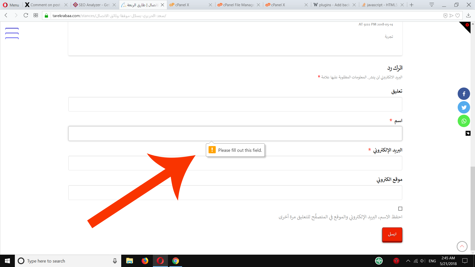

    Ein ähnlicher Fall
    Comment on post
    Hello, Plz this is the last thing i need to translate. Translating strings are not easy at all. I tried to translate this “Please fill out this field” but i…
    theme.co
    Aber
    We’re glad other translations are working now. Yes I can see the issue. But this is not related to theme or wordpress. That specific error message come from browser,
