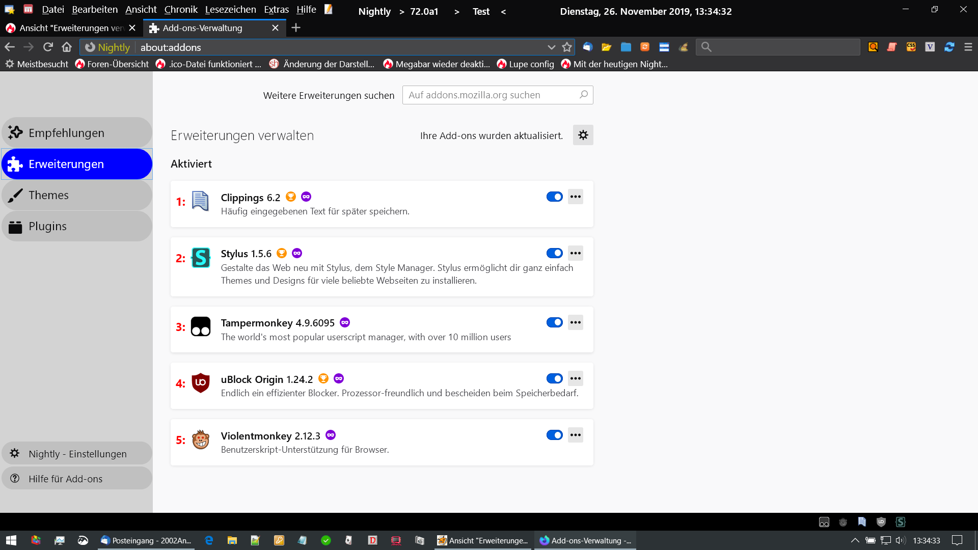

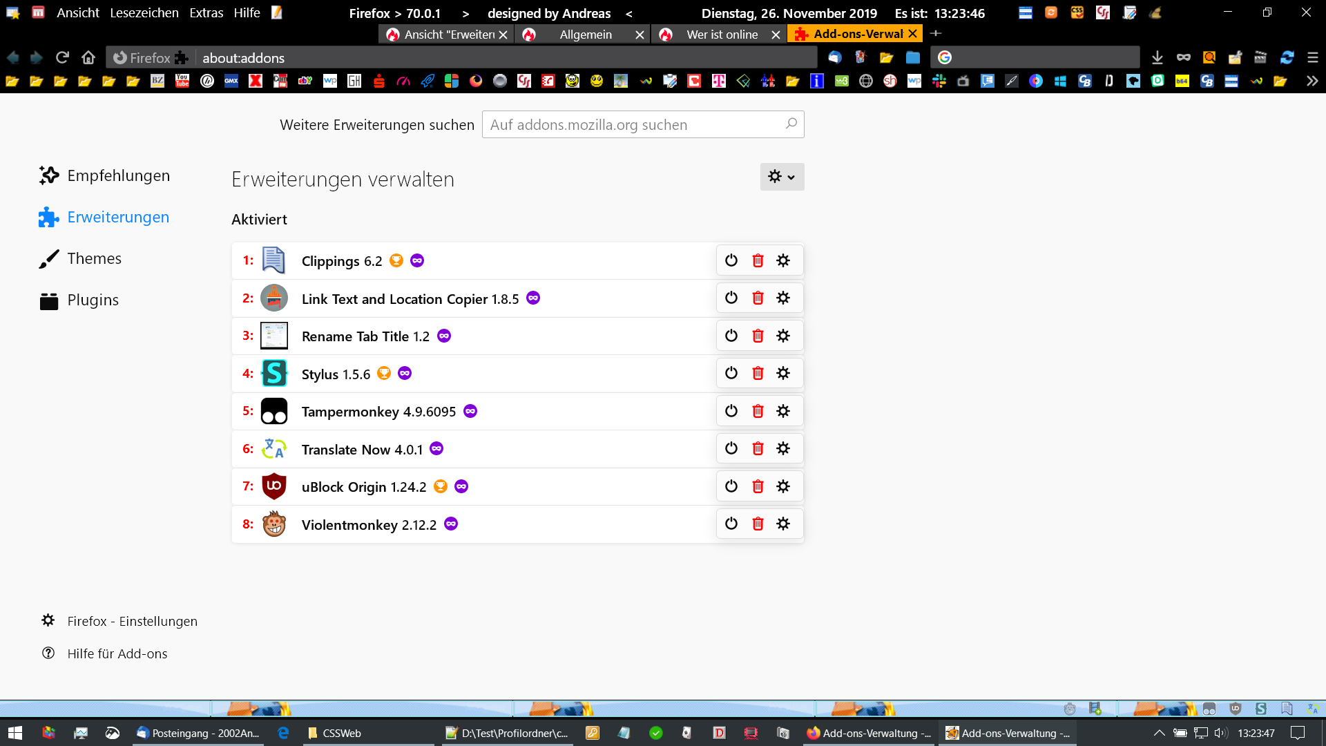

Hallo Andreas!
Wärst du so freundlich und stellst mir mal bitte den Code zur Verfügung, der zu dem Bild aus #170 gehört.
Grüße
FuchsFan
Aber gerne doch, er ist allerdings nicht kompl. von mir erstellt.![]()
@-moz-document url-prefix(chrome://mozapps/content/extensions/aboutaddons.html) {
body {
counter-reset: section;
#main > div:nth-child(1) > addon-list:nth-child(1) > section:nth-child(2) > addon-card:nth-child(n+2) > div:nth-child(1) > div:nth-child(2)::before,
#main > div:nth-child(1) > addon-list:nth-child(1) > section:nth-child(3) > addon-card:nth-child(n+2) > div:nth-child(1) > div:nth-child(2)::before {
color: red !important;
font-weight: bold !important;
counter-increment: section;
content: counter(section)": ";
padding-right: 8px !important;
margin-top:-10px!important;
margin-left: -8px !important;
button:-moz-focusring {
box-shadow: none !important;
outline: 0px dotted !important;
outline-offset: 0px !important;
#updates-container {
margin-right: -310px !important;
color: green !important;
#updates-container label#updates-installed, #updates-downloaded {
color: blue!important;
font-weight: bold;
margin-right: -90px !important;
#header-utils-btn {
margin-right: 25px !important;
panel-item[action="remove"] {
--icon: url("chrome://global/skin/icons/delete.svg");
fill: red !important;
.heading-inner {
width: 1895px !important;
margin-left: -1185px !important;
margin-top: 0px !important;
#header-inner {
margin-left: -53px !important;
margin-bottom: -61px !important;
/* Show addon management buttons without opening popup */
/* .addon-card-message{ margin-bottom: 0px !important; margin-top: 0px !important; } */
.card.addon{padding-bottom: 0px !important; }
/* addon-card .addon-card-collapsed{ display: grid !important; grid-template-areas: "ic con" "op op" } */
/* addon-card .addon-card-collapsed{ display: grid !important; grid-template-areas: "ic con op" } */
addon-card .addon-card-collapsed{ grid-template-areas: "ic con op" }
.more-options-menu{ position: static !important; grid-area: op; margin: 0 !important; }
.card-contents{ grid-area: con }
.card-heading-icon{ grid-area: ic }
addon-card .addon { margin: 1px !important; }
.arrow,
.more-options-button,
panel-item[action="expand"]{ display: none }
div.list{ display: flex !important; flex-direction: row !important; }
panel-item[action="toggle-disabled"]{ --icon: url("chrome://browser/skin/quit.svg") }
panel-item[action="preferences"]{ --icon: url("chrome://browser/skin/settings.svg") }
panel-item[action="report"]{ display: none !important; }
/* Uncomment these if you want to hide button label - such as with compact_addons_manager */
button[role="menuitem"] > slot{ display: none !important; }
link+button{
padding: 4px !important;
width: 30px !important;
height: 30px !important;
background-position: 50% !important;
link+button::after{ display: none !important; }
/* Make the installed addons list more compact */
/* Reduce the height of the cards */
addon-list[type="extension"]{ --card-padding: 20px }
addon-card .addon-card-collapsed{ margin-bottom: -10px !important; }
/* Hide descriptions - comment out if you want to show descriptions */
addon-card:not([expanded]) .addon-description,
addon-card:not([expanded]) .addon-card-message button[action]{ display: none !important; }
.more-options-menu{ margin-top: -17px !important; margin-left: 54px !important; }
.card-contents{ margin-top: -7px !important; margin-bottom: 20px !important; }
.card-heading-icon{ margin-top: -15px !important; } /**/
/* Make the header more compact */
addon-options > panel-list{
font-size:8px !important;
border-color: rgb(220,220,220) !important;
background-color: rgb(251,251,251) !important;
display: block !important;
padding: 2px !important;
margin: 0px calc(0px - var(--card-padding)) !important;
FuchsFan Das liegt daran, dass button ein Standard-HTML-Element ist, das auf allen Webseiten verwendet werden kann. Trotzdem dachte ich, dass die Regel dank der @-moz-document-Zeile sich nur auf den Add-on-Manager beschränken müsste.
