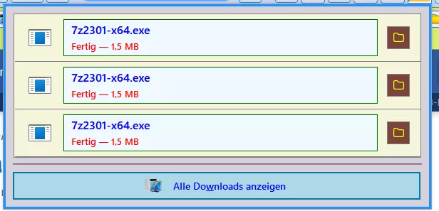

Für das Popup-Menü stelle ich hier mal meine Version zur Verfügung.
@-moz-document url(chrome://browser/content/browser.xhtml){
/* Popup-Menü anpassen */
#downloadsPanel-multiView #downloadsPanel-mainView {
min-width: 50em !important;
max-width: 50em !important;
background-color: #D5D2D9 !important;
padding: 10px !important;
border: 3px solid dodgerblue !important;
/*Popup Höhe ab wann Scrollbar erscheint*/
#downloadsListBox {
max-height: auto !important;
overflow-y: auto !important;
/* Keine Downloads in dieser Sitzung mittig */
.panel-view-body-unscrollable {
display: grid !important;
justify-items: safe center !important;
justify-content: safe center !important;
/* Keine Downloads in dieser Sitzung / Icon */
#emptyDownloads {
appearance: none !important;
background: url("file:///C:/FoxIcons/0011.png") no-repeat !important;
background-position: 0px 23px !important;
background-size: 22px 22px !important;
padding-left: 40px !important;
color: red !important;
font-weight: bold !important;
font-size: 15px !important;
/* Button "Alle Downloads anzeigen" */
#downloadsFooterButtons button#downloadsHistory.downloadsPanelFooterButton{
width: 47.7em !important;
margin-top: 6px !important;
background: lightblue !important;
border: 2px solid #007aa5 !important;
border-radius: 0 !important;
#downloadsFooterButtons button#downloadsHistory.downloadsPanelFooterButton:hover{
background: lightyellow !important;
border: 2px solid green !important;
/*Alle Downloads anzeigen / Text und Icon */
#downloadsFooterButtons button#downloadsHistory.downloadsPanelFooterButton hbox.box-inherit.button-box label.button-text {
background: url("file:///C:/FoxIcons/computer24.png") no-repeat !important;
background-position: 0px -5px !important;
background-size: 24px 24px !important;
/* Alle Downloads anzeigen / Text */
margin-left: 175px !important;
color: blue !important;
font-size: 14px !important;
font-weight: 600 !important;
#downloadsFooterButtons button#downloadsHistory.downloadsPanelFooterButton:hover hbox.box-inherit.button-box label.button-text {
color: brown !important;
/* Download-Liste */
#downloadsListBox {
background: beige !important;
/* color: black !important; */
padding: 0px 0px 0 10px !important;
border: 1px solid grey !important;
richlistitem.download-state > hbox> vbox {
background: #f0f8ff !important;
outline: inset 1px !important;
outline-color: green !important;
margin-left: 10px !important;
margin-right: 10px !important;
padding-left: 10px !important;
height: 50px !important;
richlistitem.download-state > hbox> vbox:hover {
/* unten Border in der Download-Liste */
#downloadsListBox richlistitem.download-state{
border-bottom: 1px solid grey !important;
margin-left: -9px !important;
margin-top: 0px !important;
margin-bottom: 0px !important;
padding: 0 0px 0 15px !important;
/* Name des Downloads in der Liste */
.downloadTarget {
font-size: 16px !important;
/*die Details darunter / Textfarbe*/
.downloadDetails.downloadDetails {
font-size: 13px !important;
opacity: 1 !important;
/* rechts Button "In Ordner anzeigen" */
#downloadsPanel-mainView vbox.panel-view-body-unscrollable richlistbox#downloadsListBox richlistitem.download-state button.downloadButton{
background-color: #79443b !important;
margin-right: 15px !important;
#downloadsPanel-mainView vbox.panel-view-body-unscrollable richlistbox#downloadsListBox richlistitem.download-state button.downloadButton:hover{
border: 1px solid green !important;
background-color: #ffe4b5 !important;
/* fill: blue !important; */
.downloadIconShow > .button-box > .button-icon {
fill: yellow !important;
.downloadIconShow:hover > .button-box > .button-icon {
fill: red !important;
