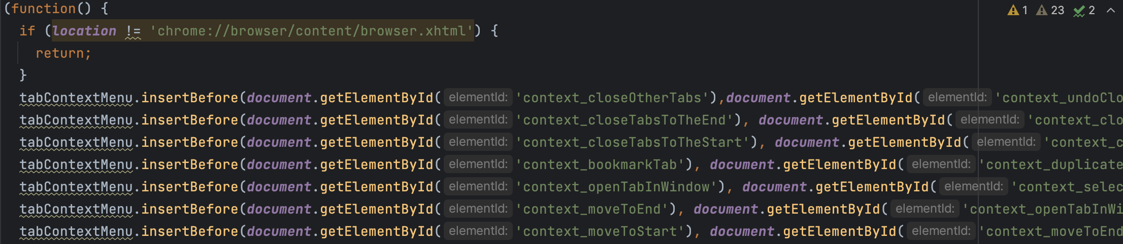

			Blöd ist, wenn man/frau an Schlafstöhrungen leidet. Gut ist, wenn man Beschäftigung hat! Habe, auch durch Anregung von aborix, das Script etwas optimiert. Hier nun die derzeitige Version. JavaScript
 Alles anzeigen(function() { if (location != 'chrome://browser/content/browser.xhtml') { return; } tabContextMenu.insertBefore(document.getElementById('context_closeOtherTabs'),document.getElementById('context_undoCloseTab')); tabContextMenu.insertBefore(document.getElementById('context_closeTabsToTheEnd'), document.getElementById('context_closeOtherTabs')); tabContextMenu.insertBefore(document.getElementById('context_closeTabsToTheStart'), document.getElementById('context_closeTabsToTheEnd')); tabContextMenu.insertBefore(document.getElementById('context_bookmarkTab'), document.getElementById('context_duplicateTab')); tabContextMenu.insertBefore(document.getElementById('context_openTabInWindow'), document.getElementById('context_selectAllTabs')); tabContextMenu.insertBefore(document.getElementById('context_moveToEnd'), document.getElementById('context_openTabInWindow')); tabContextMenu.insertBefore(document.getElementById('context_moveToStart'), document.getElementById('context_moveToEnd')); tabContextMenu.insertBefore(document.getElementById('context_closeTab'), document.getElementById('fbcbdc47-ebd2-42f0-b2bb-7cc902ec2f40_-menuitem-_add-current-tab-menu')); tabContextMenu.insertBefore(document.createXULElement('menuseparator'), document.getElementById('context_closeTab')); Components.utils.import("resource://gre/modules/Services.jsm"); let ss = Components.classes["@mozilla.org/content/style-sheet-service;1"].getService(Components.interfaces.nsIStyleSheetService); let custom_label = { init: function() { let uri = Services.io.newURI("data:text/css;charset=utf-8," + encodeURIComponent(` @namespace html url("http://www.w3.org/1999/xhtml"); #context_moveToStart label, #context_moveToEnd label, #context_openTabInWindow label, #context_closeOtherTabs label { display: none !important; } #context_moveToStart::after { content: "Tab an Anfang verschieben" !important; font-size: 13px !important } #context_moveToEnd::after { content: "Tab an Ende verschieben" !important; font-size: 13px !important } #context_openTabInWindow::after { content: "Tab in neues Fenster verschieben" !important; font-size: 13px !important } #context_closeOtherTabs::after { content: "Alle anderen Tabs schließen" !important; font-size: 13px !important } #context_reloadTab, #context_toggleMuteTab, #context_pinTab, #context_duplicateTab, #context_moveTabOptions, #context_selectAllTabs, #context_closeTabOptions, #context_undoCloseTab, #_fbcbdc47-ebd2-42f0-b2bb-7cc902ec2f40_-menuitem-_add-current-tab-menu { display: none !important; } #tabContextMenu > menuseparator:nth-child(37) { display: none !important; } `), null, null); ss.loadAndRegisterSheet(uri, ss.AGENT_SHEET); } }; custom_label.init(); })();Wenn ich jetzt noch auf den CSS-Code verzichten könnte, ....
			Habe, auch durch Anregung von aborix, das Script etwas optimiert. Du nutzt keine lokalen Variablen mehr. Das ist in Ordnung. Aber inwiefern ist das optimiert? Ich find's jetzt eher schwerer lesbar, insbesondere dadurch, dass die Zeilenlänge jetzt länger als empfohlen ist (beachte die vertikale Linie):  Bei Überschreitung einer gewissen Zeilenlänge müssen die Augen bewegt werden, um die ganze Zeile erfassen zu können. Falls du dich fragst, wieso die location-Zeile in dem Screenshot so merkwürdig dargestellt wird: Genau wegen dieses Vergleiches, der nicht so umgesetzt ist, wie ich es empfohlen hatte:
			Habe, auch durch Anregung von aborix, das Script etwas optimiert. Du nutzt keine lokalen Variablen mehr. Das ist in Ordnung. Aber inwiefern ist das optimiert? Ich find's jetzt eher schwerer lesbar, insbesondere dadurch, dass die Zeilenlänge jetzt länger als empfohlen ist (beachte die vertikale Linie):  ... Bei Überschreitung einer gewissen Zeilenlänge müssen die Augen bewegt werden, um die ganze Zeile erfassen zu können. Ok, optimiert ist vielleicht nicht unbedingt der richtige Begriff. Können wir uns auf komprimiert einigen? Wer es so nicht mag, muss es ja nicht übernehmen, und es ist ja auch nur ein Test. Die vorhergehende Version habe ich ja noch, für den Fall, dass ich in ein paar Tagen nicht mehr weiß, was ich da überhaupt gemacht habe.  Falls du dich fragst, wieso die location-Zeile in dem Screenshot so merkwürdig dargestellt wird: Genau wegen dieses Vergleiches, der nicht so umgesetzt ist, wie ich es empfohlen hatte:  Hatte ich mich ehrlich gesagt nicht. Mir fällt auch gar nicht auf, dass da etwas merkwürdig dargestellt wird! Nur das bei Dir da wohl auf etwas hingewiesen wird. Ich nutze "Visual Studio Code" und bei mir sieht es ganz anders aus! Also es wird nichts markiert, meine ich. Was nutzt Du den für ein Programm, oder welches Plugin? ABER, wenn ich if (location !== 'chrome://browser/content/browser.xhtml') verwende, funktioniert das Script nicht mehr. Des halb habe ich ein "=" weg gelassen. Nachtrag! Im Übrigen verhält es sich in beiden Versionen so! Ein zweites "=" in der if (location != 'chrome://browser/content/browser.xhtml')-Zeile, also if (location !== 'chrome://browser/content/browser.xhtml') und schon funktioniert das Script nicht mehr. Mach' ich da was Falsch? Fehlt da noch was?
			Hatte ich mich ehrlich gesagt nicht. Mir fällt auch gar nicht auf, dass da etwas merkwürdig dargestellt wird! In meinem Screenshot ist der Vergleichsoperator unterkringelt und die komplette Bedingung farbig hinterlegt.  Was nutzt Du den für ein Programm, oder welches Plugin? PhpStorm:  PhpStorm: PHP-IDE und Code-Editor von JetBrainsPhpStorm ist ein Entwicklungstool für PHP- und Webprojekte. Es ist eine perfekte PHP-IDE für die Arbeit mit Laravel, Symfony, Drupal, WordPress und vielen…www.jetbrains.comAlles anzeigen PhpStorm: PHP-IDE und Code-Editor von JetBrainsPhpStorm ist ein Entwicklungstool für PHP- und Webprojekte. Es ist eine perfekte PHP-IDE für die Arbeit mit Laravel, Symfony, Drupal, WordPress und vielen…www.jetbrains.comAlles anzeigenABER, wenn ich if (location !== 'chrome://browser/content/browser.xhtml') verwende, funktioniert das Script nicht mehr. Des halb habe ich ein "=" weg gelassen.
 Nachtrag!Im Übrigen verhält es sich in beiden Versionen so! Ein zweites "=" in der if (location != 'chrome://browser/content/browser.xhtml')-Zeile, also if (location !== 'chrome://browser/content/browser.xhtml') und schon funktioniert das Script nicht mehr. Mach' ich da was Falsch? Fehlt da noch was? Das schrieb ich zwar schon ein paar Mal, aber gerne nochmal:  location.href !== 'chrome://browser/content/browser.xhtml'
			PhpStorm: https://www.jetbrains.com/de-de/phpstorm/ Das schrieb ich zwar schon ein paar Mal, aber gerne nochmal:  location.href !== 'chrome://browser/content/browser.xhtml' Die Latte, die Du mir dauernd um die Ohren haust muss ja ganz schön was aushalten. Hab's begriffen, also nur zum Teil. Sorry Damit das Script funktioniert muss auch aus location !=, location.href !== werden. Sonst wird das nix mit einem zweiten "=". Präg' Dir das ein Mira!
 Das location != ist zu Fehlertolerant, location.href !== ist "strenger".PhpStorm ist nur für so zum Spaß dann doch für mich etwas zu "Überdimensioniert".
			Das location != ist zu Fehlertolerant, location.href !== ist "strenger". Ich würde es nicht fehlertolerant nennen, weil die andere Schreibweise auch nicht falsch ist. Aber mit !== findet eine Typen-Prüfung statt und dann ergibt der Vergleich zwischen einem Objekt (was location ist) und einem String (also quasi einem Text in Anführungszeichen) keine Übereinstimmung. Durch eine von JavaScript vorgenommene implizite Typen-Umwandlung entstehen gerne Fehler durch unerwartetes Verhalten, wenn man in der Programmierung nicht aufpasst. In diesem Fall ändert das am Ergebnis nichts. Das ist einfach wieder ein Fall von gutem Code-Stil, den man sich angewöhnen kann, um das Fehler-Risiko bei komplexeren Codes zu minimieren. Also in Bedingungen einfach immer strikt prüfen, sprich === statt == und !== statt !=. Ich hab das hier auch nur angemerkt, weil ich bei dir die Bereitschaft erkenne, dazu zu lernen. Würdest du einfach nur funktionierende Codes wollen, ganz egal wie, hätte ich das gar nicht so groß ausgeführt. Thema wurde das ja eh erst dadurch, dass ich bei der Verschönerung des Codes, den ich ich dir anbieten wollte, einen Fehler an genau dieser Stelle eingebaut hatte.  PhpStorm ist nur für so zum Spaß dann doch für mich etwas zu "Überdimensioniert".
