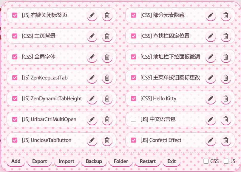

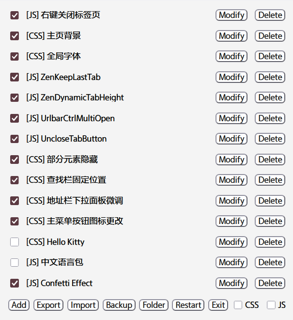

    AI-Generated UserChrome Manager
    [!CAUTION]
    Disclaimer: This project is entirely AI-generated. It may contain unexpected bugs or issues. Please use with caution and back up your configuration.
    This is a customized UserChrome (UC) Manager created using AI to suit my personal workflow. It is designed for streamlined management of CSS and JS tweaks.
    Note: Unlike traditional managers, this tool does not auto-scan or load local files from the chrome folder. All rules must be manually added or imported. All data is stored in:
    chrome/userchromerules.json
    ✨ Key Features
    • Unified Management: Manage both CSS and JS within a single interface.
    • Dynamic Toggling: Supports real-time enabling/disabling of JS scripts (requires the script to return a cleanup function).
    • Custom Storage: Keeps your browser directory clean by centralizing rules in a JSON file.
    🚀 How to Use

    1. UserChromeRulesKitty.css
    A Hello Kitty themed style for the manager interface.
    • Layout Customization: By default, the manager uses a single-column layout. If you have many scripts and prefer a multi-column view, simply add the following CSS rule:
      #ucm-main-dialog .ucm-grid {
        --ucm-grid-columns: 2; /* Change this number to adjust columns */
