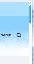

    Zitat von Endor
    Hallo zusammen.
    Habe vor einiger Zeit, dieses Script entdeckt:
    scrollbars-minimal.uc.js
    Damit wird die Scrollbar nur noch ganz dünn dargestellt.
    Script:
    JavaScript
    (function() {
    var css =`
    scrollbar {
    z-index: 2147483647 !important;
    position: relative !important;
    scrollbar,
    scrollbar * {
    margin: 0px !important;
    padding: 0px !important;
    border: 0px !important;
    box-shadow: none !important;
    scrollbar[orient="vertical"] {
    -moz-margin-start: 0px !important;
    max-width: 12px !important;
    min-width: 12px !important;
    /*background: #38383d !important;*/
    background: transparent !important;
    background-size: 12px 12px !important;
    background-repeat: repeat-y !important;
    background-position: 50% 0% !important;
    cursor: default;
    scrollbar[orient="horizontal"] {
    margin-top: 0px !important;
    max-height: 12px !important;
    min-height: 12px !important;
    background-repeat: repeat-x !important;
    background-position: 0% 50% !important;
    cursor: default;
    /*scrollbar[orient="vertical"]:hover {
    background: #ddd !important;
    transition: all 0.08s !important;
    scrollbar[orient="horizontal"]:hover {
    scrollbar thumb[orient="vertical"] {
    min-height: 24px !important;
    scrollbar thumb[orient="horizontal"] {
    min-width: 24px !important;
    scrollbar thumb {
    border-radius: 6px !important;
    border: 2px solid rgba(0,255,255,0) !important;
    box-shadow: 0 0 0 8px #23a1ff inset !important;
    transition: all 0.04s !important;
    opacity: 1 !important;
    scrollbar:hover thumb {
    box-shadow: 0 0 0 8px #1876bc inset !important;
    scrollbar thumb:active {
    box-shadow: 0 0 0 8px #0c3c60 inset !important;
    background: #1876bc !important;
    scrollbar, scrollcorner {
    /*background-color: #38383d !important;*/
    background-image: unset !important;
    /*scrollbar gripper {
    box-shadow: 0 0 0 8px red inset !important;
    background: blue !important;
    /* no buttons */
    scrollbar:hover scrollbarbutton {
    scrollbar:active scrollbarbutton {
    scrollbar scrollbarbutton:hover {
    scrollbar scrollbarbutton:active {
    scrollbar scrollbarbutton {
    /*box-shadow: 0 0 0 8px #23a1ff inset !important; */
    box-shadow: 0 0 0 8px rgba(100,100,100,0.3) inset !important;
    var sss = Cc['@mozilla.org/content/style-sheet-service;1'].getService(Ci.nsIStyleSheetService);
    var uri = makeURI('data:text/css;charset=UTF=8,' + encodeURIComponent(css));
    sss.loadAndRegisterSheet(uri, sss.AGENT_SHEET);
    Sieht damit dann so aus:
    Vielleicht kann es ja jemand von euch brauchen.
