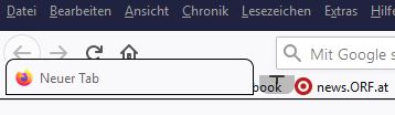

    Hallo!
    Wie bekomme ich die blau Leiste am oberen Rand weg wenn der Tab grade ausgewählt ist?
    hier meine CSS:
    @-moz-document url(chrome://browser/content/browser.xhtml) {
    #TabsToolbar {
        display:block !important;
        bottom: -4px !important;
        width: 100vw !important;
        background:  #F9F9FA !important;
    #tabbrowser-tabs {
    #main-window:not([chromehidden*="toolbar"]) #navigator-toolbox {
        padding-bottom: var(--tab-min-height) !important;
    :root {
        --tab-min-height: 35px !important;
    :root #tabbrowser-tabs {
    /*.tabbrowser-tab:not([selected="true"]){*/
    .tabbrowser-tab:not([selected]) {
        background: rgb(249,249,250) !important;
        border: 1px solid black !important;
        color: black !important;
        border-radius: 8px !important;
    .tab-background[selected] {
        font-weight: bold !important;
    #tabs-newtab-button {
        margin-left: 5px !important;
        padding: -10px !important;
        fill: rgb(0,0,0) !important;
        background-color: rgb(187,187,187) !important;
    .tab-close-button {
        display: none !important;
    .tabbrowser-tab:hover .tab-close-button {
        display: block !important;
